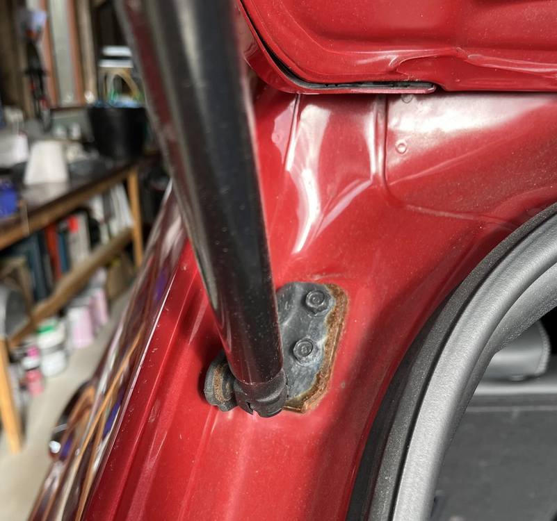

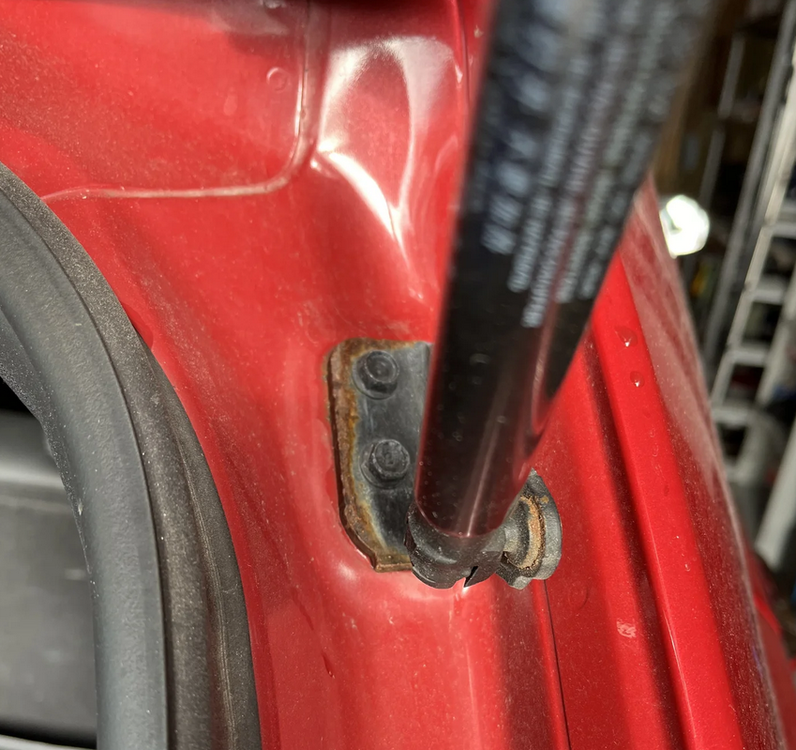

NAVITEL Posted April 13, 2024 Share Posted April 13, 2024 I am feeling rather let down today. This afternoon, I was rectifying a prevalent issue with Kia vehicles: the malfunctioning of the rear washer. I discovered that the rear NRV (non-return valve) was immobilised and extracted its internal components. After reinserting it, the result was a sudden and forceful flow. While reattaching the trim, I saw that the top brackets for the rear struts had signs of corrosion. It is regrettable that I did not discover this earlier. I captured photographs and sent them via email to our exclusive Kia Dealer in this area. In response, the dealer informed me that the warranty does not cover the mentioned items. The automobile is a mere 3 years old and is stored in the garage every night. While I acknowledge the possibility of my error, it is reasonable to expect that the brackets on any automobile, particularly one with a value of £30,000, should have a lifespan beyond 3 years. I will attempt to acquire the brackets, with the goal that they will not be excessively costly. Has anybody else encountered this problem? Quote Link to comment Share on other sites More sharing options...
diablos_carcv5 Posted April 13, 2024 Share Posted April 13, 2024 Consider removing the brackets, cleaning them well, and applying a coat of spray paint, such as Hammerite, before reinstalling them. It is difficult to determine, but it seems that the bodywork is still in good condition. Quote Link to comment Share on other sites More sharing options...
nickoyster4 Posted April 13, 2024 Share Posted April 13, 2024 That was my first assumption, that a coat of hammerite or smoothrite would suffice, completing the task and perhaps resulting in a more aesthetically pleasing appearance than the original painting. Quote Link to comment Share on other sites More sharing options...
NAVITEL Posted April 13, 2024 Author Share Posted April 13, 2024 Thank you for the responses received so far. Indeed, I acknowledge that I may have shown an excessive emotional response. However, I remain dissatisfied with the current standard of some fittings. I will examine the struts tomorrow to see the process of their removal. I own rust treatment and paint that I acquired from past projects. Quote Link to comment Share on other sites More sharing options...
WanderlustGuru Posted April 13, 2024 Share Posted April 13, 2024 My device has had the same issue. Permit a little amount of time for off-road activities. To support the hatch, it is necessary to utilise a sweeping brush, since a single strut is insufficient to bear the weight. I completed each task individually. Separate the strut and remove the bracket. Upon observation, one will notice the presence of a slender gasket positioned between the bracket and the body. I created a new one using a slender sheet of plastic. Unless you are able to remove the old gasket without causing any damage. A thorough massage. I applied a rust inhibitor to the affected area. The object was coated with Halfords Satin black paint after being prepared and applied with precision. Baked in the oven. The gasket and body were coated with waterproof grease throughout the refitting process. I have completed one side and still need to complete the other half since winter has taken over. Quote Link to comment Share on other sites More sharing options...

NAVITEL Posted April 13, 2024 Author Share Posted April 13, 2024 I have been unwell for a few days (I am still experiencing discomfort). I reached out to our only Kia Dealer, who informed me that he had previously attempted to address this very problem with Kia on behalf of another customer. However, Kia's response was that because they had not experienced any failures, they are not liable to provide coverage. Regarding the yearly bodywork check, I was informed that there is no authorised Kia representative available here to do the inspection. Therefore, it has not been conducted or certified. I am now using a wire brush to clean the brackets individually. After that, I am applying an anti-rust coating and then brushing on two coats of Satin Hammerite paint. Unfortunately, the local garage did not have any black aerosol paint available, so I would have to go 50 miles round trip to the next autostore to get it. I am propping up the back hatch with a wooden beam. Quote Link to comment Share on other sites More sharing options...
