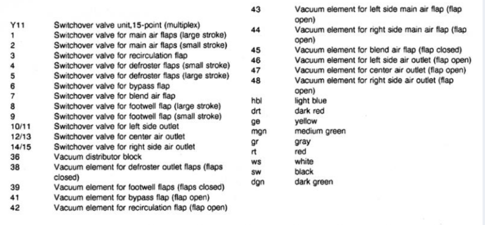

xsports Posted November 13, 2023 Share Posted November 13, 2023 Quote Link to comment Share on other sites More sharing options...
another_clean_sheet Posted November 13, 2023 Author Share Posted November 13, 2023 I express my gratitude for your assistance. I have familiarised myself with the hoover system. The complexity of these automobiles is notable, since they exhibited a high level of advancement relative to the era in which they were produced. It is presumed that the reference to the "passenger side UK" pertains to the positioning of the passenger side in vehicles driven in the United Kingdom. I will examine the matter in the morning. Is it a straightforward process to experience being forcibly expelled and having an object get dislodged? Quote Link to comment Share on other sites More sharing options...
xsports Posted November 13, 2023 Share Posted November 13, 2023 It is probable that the operator diaphragm has failed. To assess the vacuum integrity, one may use a handheld vacuum pump to locate the operational line. Addressing the issue of a potential leak in the operator itself may provide a distinct challenge. Quote Link to comment Share on other sites More sharing options...

another_clean_sheet Posted November 13, 2023 Author Share Posted November 13, 2023 I successfully identified and rectified the issue independently, at a cost of less than £3, by acquiring a replacement vacuum pipe connection. Quote Link to comment Share on other sites More sharing options...
xsports Posted November 13, 2023 Share Posted November 13, 2023 I am pleased that the issue was resolved at a relatively low cost, at a location that is easily accessible and not deeply embedded inside the internal components of the heater/air conditioning system. Was the leakage seen on the air handler assembly or the 15-way switchover valve assembly? Â Quote Link to comment Share on other sites More sharing options...
another_clean_sheet Posted November 13, 2023 Author Share Posted November 13, 2023 Upon raising the bonnet, it was seen that the location of interest was situated on the near side of the vehicle, namely in close proximity to the bonnet hinge, according to the standard configuration in the United Kingdom. A tiny connection module. Readily apparent and conveniently accessible. I had a sense of great satisfaction and perceived myself to be fortunate. Quote Link to comment Share on other sites More sharing options...
another_clean_sheet Posted November 13, 2023 Author Share Posted November 13, 2023 Quote Link to comment Share on other sites More sharing options...
xsports Posted November 13, 2023 Share Posted November 13, 2023 The adage "a picture is worth a thousand words" might perhaps provide assistance to a fellow owner of an R129 vehicle in the future. Quote Link to comment Share on other sites More sharing options...
