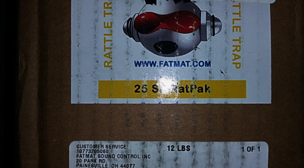

Doncaster34 Posted September 12, 2023 Share Posted September 12, 2023 It is advisable to install the material on days with warmer to hot temperatures. The material exhibits enhanced ease of manipulation and adaptability to conform to irregular shapes. The front fender wells provide a significant issue. It is important to acknowledge that the panels of sedans are composed of plastic material, necessitating the use of additional fasteners to enhance their structural strength. If the CS Catch Can had been fitted, it would have provided the opportunity to see the appearance under the wheel liner. Apologies for the obstruction caused by the flash, which obscured the measurement of square footage (SF). The mentioned SF pertains to the additional FAT MAT being used for my independent hood project. Quote Link to comment Share on other sites More sharing options...
