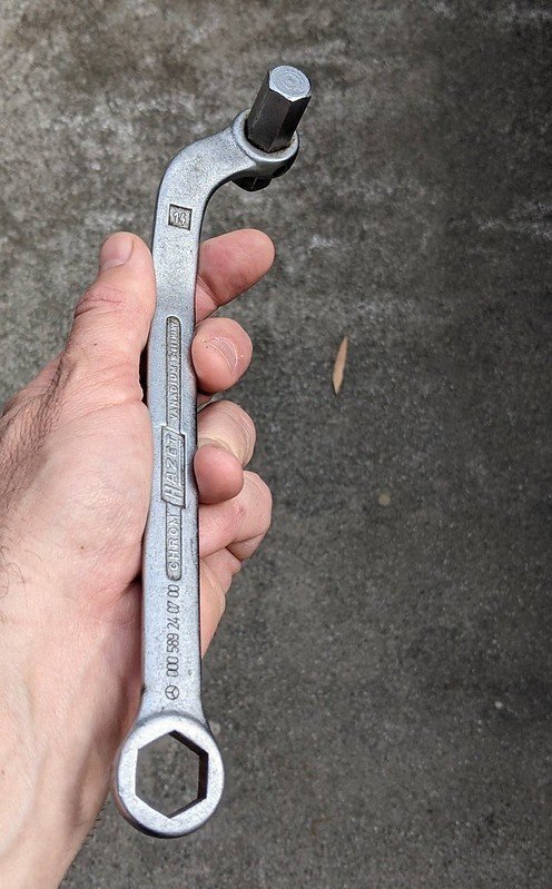

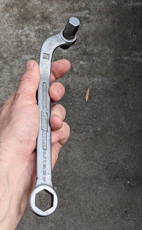

correction: OH, and I honestly don't recall what instrument I used to empty the front fluid. I accomplished this after completely replacing the diff; after that ordeal, removing the drain cap was a breeze. I probably also used my schwaben 14/17mm allen/box wrench set.
