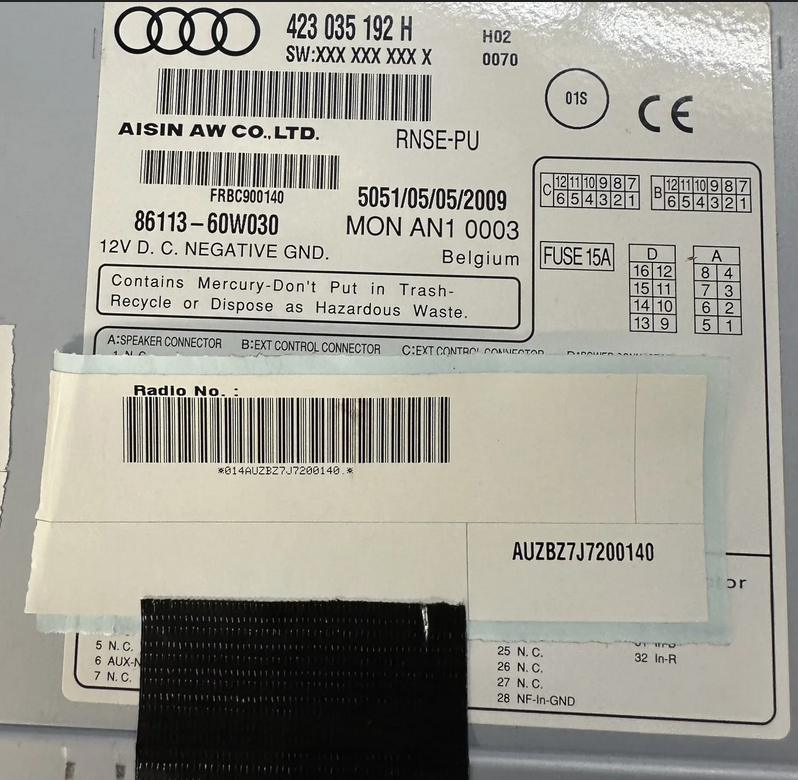

After doing a search, I have come across other individuals that have the same issue as me, although there is no definitive solution. Each time the phone establishes a connection. BT is successfully linked to the DIS and functions well. Upon accessing the Tel feature on the device, I am informed that the telephone is now unavailable. However, I am able to respond to incoming calls on my phone, since the call is being sent over the radio. I have no control over any aspect of the device, and none of the comfort functions are functional during this period (such as the radio muting when it rings). If I do a hard reset, the device will go back to its previous state. Is there a software update available that might potentially resolve this issue? The BT module seems to be unable to complete synchronisation until I remove the phone and restart it, or do a hard reset on the RSNE. During this occurrence, the MMI or signal bars do not display the BT, unlike when it synchronises properly. The system will function well, and once I exit the vehicle and all the modules are inactive, it will go back to an inoperable state. Could somebody provide insight into the current situation?
