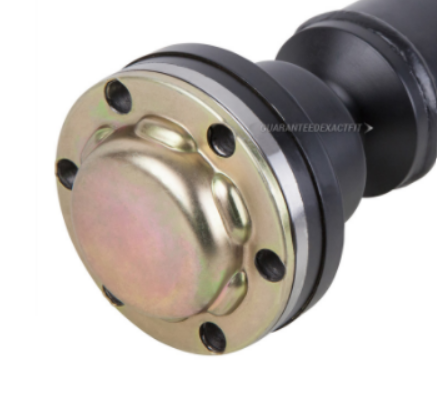

Rudy7831 Posted June 17, 2024 Share Posted June 17, 2024 Greetings. This has detached from the underside of my BMW 1 Series 118 coupe. I am inquiring about the issue where the gear box is shifting smoothly as expected, but there is no forward motion when I release the clutch, accompanied by a grinding sound. Assistance in any kind would be very appreciated. Quote Link to comment Share on other sites More sharing options...

diablos_carcv5 Posted June 17, 2024 Share Posted June 17, 2024 It seems to be components of the rear differential connected to the drive shaft. Verify that your driving shafts remain properly attached. Quote Link to comment Share on other sites More sharing options...
NevoBMW320i Posted June 17, 2024 Share Posted June 17, 2024 The grinding noise is caused by the detachment of one of the shafts from the differential, resulting in a loss of drive. Quote Link to comment Share on other sites More sharing options...

rab60bit88 Posted June 17, 2024 Share Posted June 17, 2024 Occurred on my sibling's previous generation e46 vehicle. After finishing the duel cw, the driver smoothly approached the roundabout and accelerated in order to exit, but experienced a complete lack of response. After driving for almost a hundred miles without any issues, this incident occurred only one mile away from her house. Quote Link to comment Share on other sites More sharing options...
