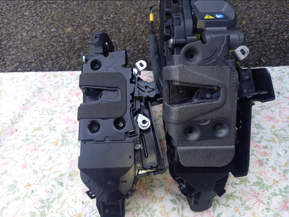

NAVITEL Posted March 21, 2024 Share Posted March 21, 2024 The keyless entry for my wife's 2017 2.0D Autobiography is available. It is not unexpected that the lock on the front passenger door has malfunctioned. I reached out to a seller on Ebay and provided them with the VIN number, registration details, and such. Subsequently, they sent the "accurate" lock to replace the defective one. After removing the lock, which was quite simple after viewing several videos, I noticed that the provided lock had three cable attachments, whereas the one I removed only has two. I have reached out to the vendor to get their guidance. I neglected to install the replacement actuator and reassembled the door in its original configuration. Is anybody aware of the specific lock that I require? Enclosed herewith is an image. The first lock located on the right-hand side exhibits a total of two cable hookups. The number of replacements is three. Thank you for your assistance. Quote Link to comment Share on other sites More sharing options...

diablos_carcv5 Posted March 21, 2024 Share Posted March 21, 2024 Greetings, It may be inferred that the emergency key is located inside the passenger door. That is the purpose of the third cable. The presence of the 3 or 2 cable/emergency key on the drivers door or passenger door of some automobiles seems to be quite arbitrary. The component numbers also seem to be rather arbitrary. Quote Link to comment Share on other sites More sharing options...
nicebubby8 Posted March 21, 2024 Share Posted March 21, 2024 The older evoques were essentially Freelander 2's dressed in a sophisticated gown. In the UK, FL2's had the emergency key located at the passenger door, which coincidentally serves as the drivers door in most other countries. It might be inferred that the Ford engineers responsible for the initial design of the FL2 encountered financial constraints that hindered their ability to get a lock system version specifically tailored for the UK market. Quote Link to comment Share on other sites More sharing options...
WanderlustGuru Posted March 21, 2024 Share Posted March 21, 2024 Greetings, I have just replaced the actuator on my passenger door. The emergency key for the MY2018 model is located inside the driver's door. I additionally used Parts Link 24. A wide variety of part numbers may be found. It is crucial to have the appropriate component for your automobile, whether it is equipped with keyless entry or keyless start. Similar to you, I procured the component from an eBay parts source and they verified its authenticity.I was informed that my VIN was incorrect for my year's component number. Nevertheless, I took the risk and placed an order for it, subsequently comparing it to the one on the vehicle. The sole distinction pertained to the inclusion of an additional connection for the emergency key. Therefore...I proceeded to install it and it works flawlessly.Please ensure that the internal handle cable and exterior handle cable are connected in accordance with the current configuration, while leaving the other cable unattached. Quote Link to comment Share on other sites More sharing options...
