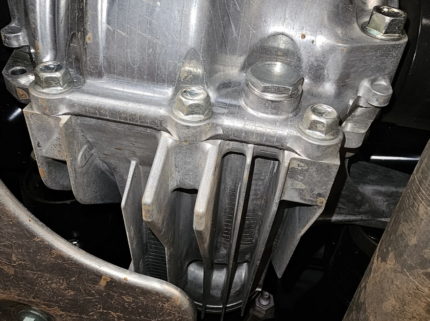

johnnyb44 Posted March 21, 2024 Share Posted March 21, 2024 I want to independently replace the oil for the first time, and concurrently, I intend to do tyre rotation, given that the odometer indicates a mileage of 10,000 miles. I own a single floor jack and two stands that I have used on each successive vehicle to secure all four corners. However, I am unable to determine the proper procedure for raising all four corners of this vehicle due to the presence of protruding fins at the rear centre jack point, potentially affecting the differential. It is imperative that I avoid causing any harm to the differential or the fins themselves. I have not yet had the opportunity to locate the front centre jack point, hence I cannot provide any information on that matter. Has anybody successfully dismantled all four corners of their CX-90? I am now experiencing difficulty in efficiently rotating the tyres without the need to raise a minimum of three corners. I would much appreciate your feedback! Quote Link to comment Share on other sites More sharing options...

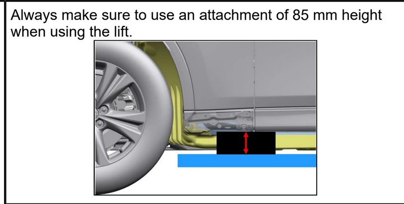

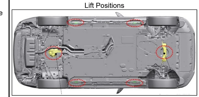

Rudy7831 Posted March 21, 2024 Share Posted March 21, 2024 This diagram is derived from a Mazda Service Alert that advises against using a flat lift on a Phev vehicle because to the potential hanging of the electric vehicle battery and other components. It specifies the need for spacers on the side lift points. Additionally, it displays Jack's points. Left rear differential. Please be aware that I have not used these centre points, but rather captured a few close-up photographs. Quote Link to comment Share on other sites More sharing options...

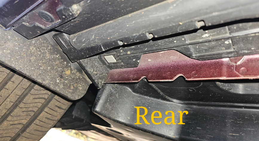

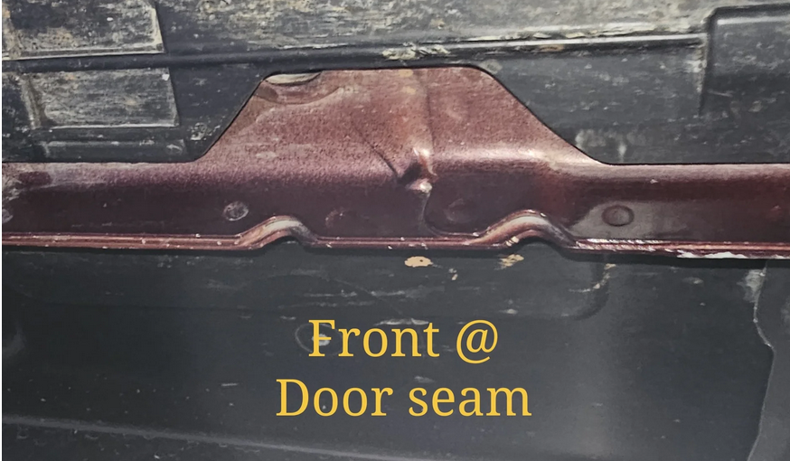

mrnobady Posted March 21, 2024 Share Posted March 21, 2024 Thank you for providing this information. I was in need of the locations of the front and rear centre points. My vehicle is a mhev, so I don't have to worry about the batteries. However, the pinch weld spots at the four corners are far closer than the photo indicates, and there is a significant amount of plastic around them. I purchased rubber pinch weld protectors from Amazon, which proved to be effective in my experimental lift setup. I do not have the same problem as the original poster, since mine is rotated during the winter exchanges. However, it would be desirable to do two tasks with a single lift. The location of the rear centre lift point is peculiar, since it appears to be associated with the rear differential rather than a flat area. I will inquire with my dealer service manager on their recommendations. Quote Link to comment Share on other sites More sharing options...

johnnyb44 Posted March 21, 2024 Author Share Posted March 21, 2024 Excellent, I appreciate you for sharing the photographs! I have located the front central jacking point and there is no need to be concerned about it. Regarding the back, it may be inferred that the two thicker fins are the location where the jack would be positioned centrally. Quote Link to comment Share on other sites More sharing options...
Rudy7831 Posted March 21, 2024 Share Posted March 21, 2024 For those who may lack familiarity with side jack points. Quote Link to comment Share on other sites More sharing options...
mrnobady Posted March 21, 2024 Share Posted March 21, 2024 According to the dealer, if you have a hitch, you may use it for the rear. However, it is advisable to utilise the side jack points instead. Quote Link to comment Share on other sites More sharing options...
johnnyb44 Posted March 21, 2024 Author Share Posted March 21, 2024 I ultimately used the differential to elevate the rear. I did not see any problems with doing this task. Quote Link to comment Share on other sites More sharing options...
