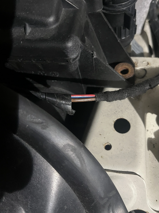

Gianni682 Posted April 6, 2024 Share Posted April 6, 2024 I just purchased a Mini One as my daughter's first vehicle. When the engine is in an idle state after being run, it will experience overheating due to the low-speed fan not activating. Although the issue has been well documented, the available solutions only address a 3-wire setup, but I am dealing with a 2-wire setup. Is there a solution available for this wire? The wires are in excellent shape, with one end connected to the motor and the other end concealed behind a wiring loom. Thank you. Quote Link to comment Share on other sites More sharing options...

Gianni682 Posted April 6, 2024 Author Share Posted April 6, 2024 I concur, however, it is worth noting that this particular automobile is equipped with just two wires that provide power to the fan, rather than the expected three. This observation implies that the resistor is not situated in close proximity to the fan. Additionally, these two lines are concealed inside the wiring harness under the fuse box. I am encountering difficulty in locating any online documentation pertaining to this specific wiring configuration. The issue is that the 2004 R50 model should have a wiring loom that is different from the one it now has. Quote Link to comment Share on other sites More sharing options...

Gianni682 Posted April 6, 2024 Author Share Posted April 6, 2024 I have been informed that the problem is most likely related to the thermostat, and replacing it should resolve the issue. While I am doing that, I will also inspect the seal. Thank you. However, it seems that the fan is only equipped with a single speed. I speculated that the fan may be equipped with dual speed functionality, and that the resistor might be concealed in an undisclosed location. Quote Link to comment Share on other sites More sharing options...
