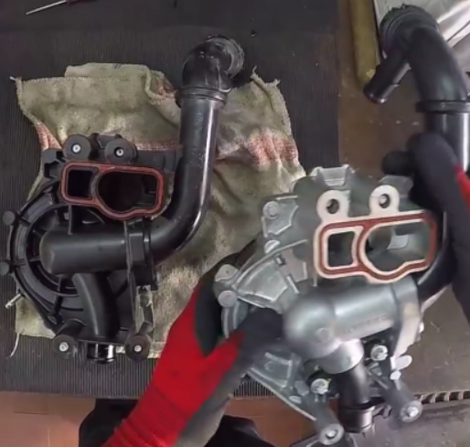

Starcar2022 Posted May 10, 2024 Author Share Posted May 10, 2024 After taking the time to examine the situation, I am confident in my assumption that the issue lies in the fuel filter housing. The pump and thermostat seem to be in good condition. Both bolts seem identical. Can this be done as a do-it-yourself project? I am not used to working on automobiles and I do not own an extensive array of tools. However, if the task just involves removing items without the need for any specialised equipment, I believe I would be capable of doing it. Quote Link to comment Share on other sites More sharing options...
motorman3 Posted May 10, 2024 Share Posted May 10, 2024 Indeed, it is a do-it-yourself project. I successfully completed mine. No specialised tools are required; only a high-quality quarter inch socket set is necessary due to limited access. It is essential that you get the 3 hole housing. (There are two existing leaks and another one will soon develop. It took me around three hours since the EGR cooler also has to be removed.) It is possible that your cylinder head may or may not include three threaded holes. In the case that it does not, just disregard the third bolt. Quote Link to comment Share on other sites More sharing options...
