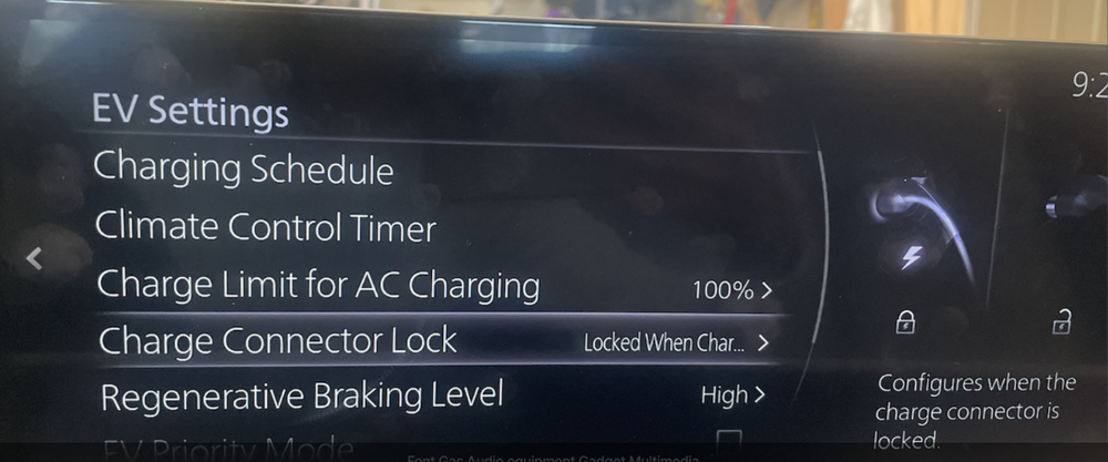

markjay Posted April 4, 2024 Share Posted April 4, 2024 Greetings, everyone. I am new to this platform. We have had our CX90 PHEV for almost one month in the cold climate of Colorado. The following is a description of my experience: Purchased the vehicle, transported it to my residence, and regularly recharge it every evening (scheduled via the application to begin at 10pm according to the local time) using a 110-volt power source. At the beginning, the indicated full charge range was consistently 26 miles, and this remained steady for the first two weeks. The current weather conditions remain same, and the battery will only charge up to a range of 16 miles until it reaches 100% capacity (see to the attached photos). I just noticed this after adjusting the charge time setting to start at 10 pm. I am interested to know whether the battery charge is affected by our driving habits, indicating a potential learning problem. Alternatively, a different option altogether. Any updates or comments on comparable occurrences would be much appreciated. Quote Link to comment Share on other sites More sharing options...
