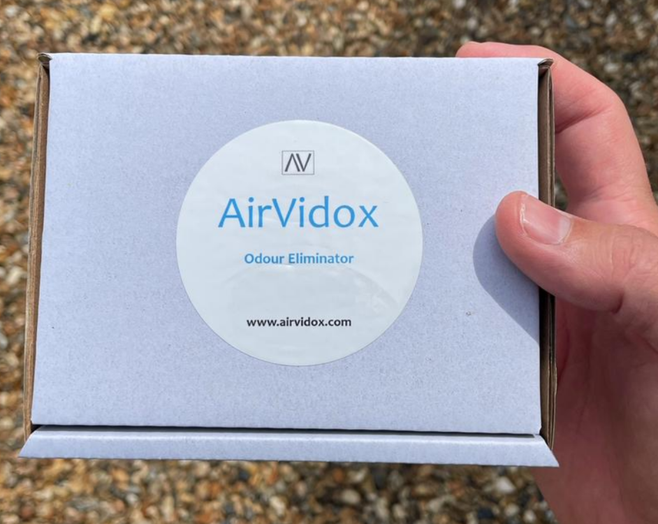

I used two distinct applications of a chemical product known as 'air vidox' in an attempt to eliminate the smoke odour from the vehicle. Regrettably, despite my efforts, the automobile continued to retain a residual scent reminiscent of a chlorinated swimming pool, and the smoke odour persisted even after the second treatment. I consistently ensured that the roof was left exposed whenever possible, and diligently performed repeated cleaning tasks on it. The vehicle in question was recently exchanged over the last month, after a period of ownership spanning four years. Despite this, there were some instances when a faint odour was still perceptible. Consequently, I can empathise with your desire to eliminate any lingering smells from an automobile. I fail to get the rationale of engaging in such arguments. As a newcomer to this community, I have encountered instances when some individuals exhibit a rather direct manner in their posts. However, overall, the majority of participants have shown a high degree of friendliness. Therefore, I encourage you to persist in your engagement and I am certain that other members will appreciate your contribution.
