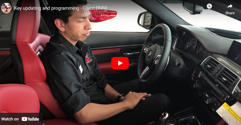

Remove all keys from the vehicle and ensure that they are positioned outside the effective range. Depress the start/stop button in order to prompt the display to indicate the absence of a remote key. Promptly position the recently acquired fob in close proximity to the key symbol located on the steering column, followed by the actuation of the start/stop button. Continuously engage the start/stop function until the diagnostic mode is visibly activated. I am prepared.

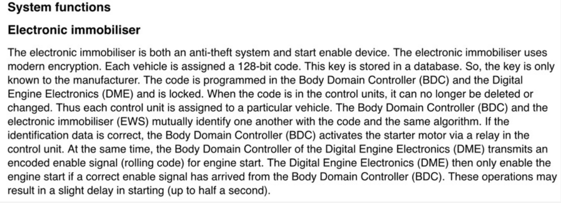

I would like to express my apologies. The aforementioned information was obtained from the International Society of Automotive Technicians and pertains to the need of obtaining a new key specifically linked to the vehicle identification number (VIN) of a BMW automobile. I failed to comprehend the information pertaining to eBay keys.
The individual in question may be classified as either a dealer or a highly skilled professional hacker, capable of nullifying the legitimacy of an eBay merchant. As previously indicated, the remote has a transponder that is programmed with a 128-bit encryption particular to the vehicle identification number (VIN) and only known by BMW. This encryption is written to many modules inside the system.
A novel remote control device is manufactured, including the aforementioned stored information, along with the inclusion of a bladder incision to accommodate the mechanical key. The Electronic Warfare System (EWS) component of the key, which initiates immobilisation, is a non-modifiable process that is specific to the corresponding modules.The communication from the key to the DME and the necessary modules/components for vehicle ignition is facilitated by the use of induction. One possible method to activate the vehicle's ignition system without the battery in the remote is by positioning the remote in close proximity to the ring antenna located inside the steering column.
The use of the battery inside the key fob is attributed to the remote's central locking and comfort access functionalities. The RF (radio frequency) signal is responsible for transmitting electricity to the car's aerials, enabling the locking and unlocking of the vehicle.
