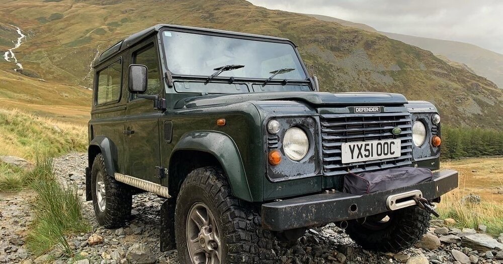

johnmayerrr Posted July 21, 2023 Share Posted July 21, 2023 Hi, I want to change the tyres on my standard-height Land Rover Defender 90. I have 235/85/16 tyres on my sawtooths right now, which are et20?! Could I switch to 255/85 without making many changes? Any pictures would be fine. I can't find any sawtooths that have 255/85 tyres on them!! Quote Link to comment Share on other sites More sharing options...
nickoyster4 Posted July 21, 2023 Share Posted July 21, 2023 The 255/85s will be higher but thinner than the 265/75s I use on my 16-inch sawtooths, so they should fit without an issue. Since the 255/85s are often only available in an MT, it's worth noting that you may want to consider beads rather than normal weights for balance purposes. It's possible that a little tweak to the stops is all that's needed to eliminate friction at full steering lock. The ET20 specification will be stamped on the hub of factory-fresh sawtooth wheels. Quote Link to comment Share on other sites More sharing options...
